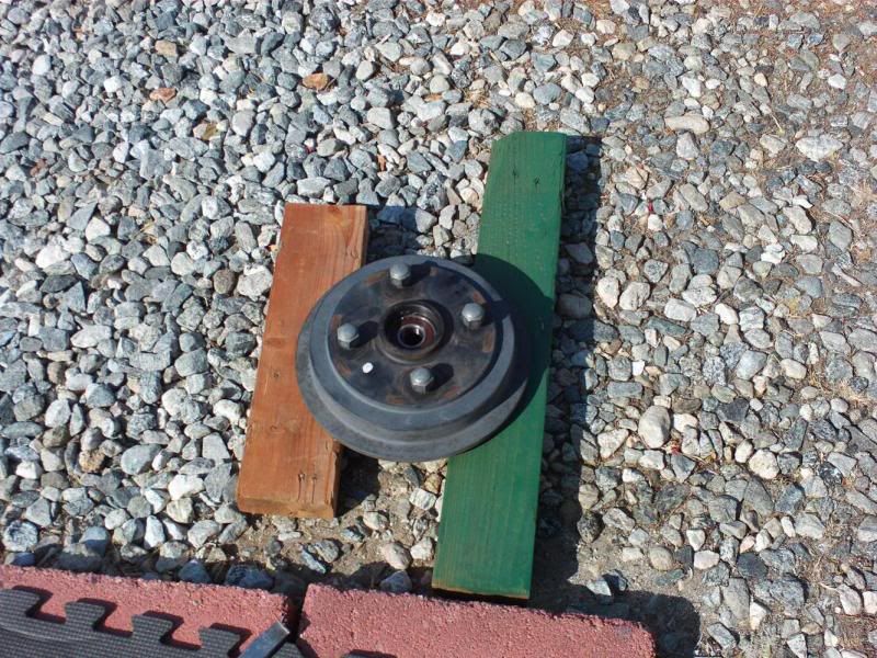

Now that the hub is off, we need to go high tech.
Here is the hub
surrounded by our super high tech wheel bearing removal tools.
You elevate the hub a bit
again we are using some mismatched pieces of wood to lift the hub.
Then you take that long rod, and put it into the lower bearing inner race and give it a few wacks.
Turn it 180 degrees and do it again.
Then, you should have your bearing out.
