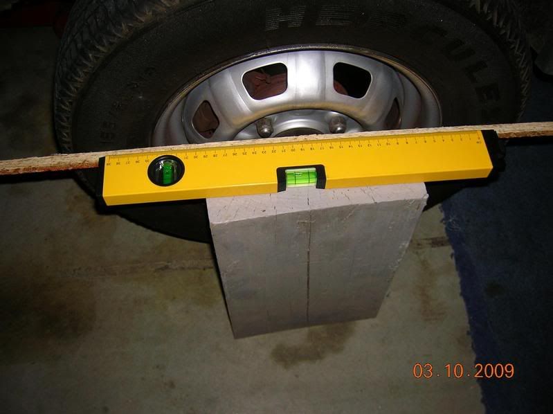

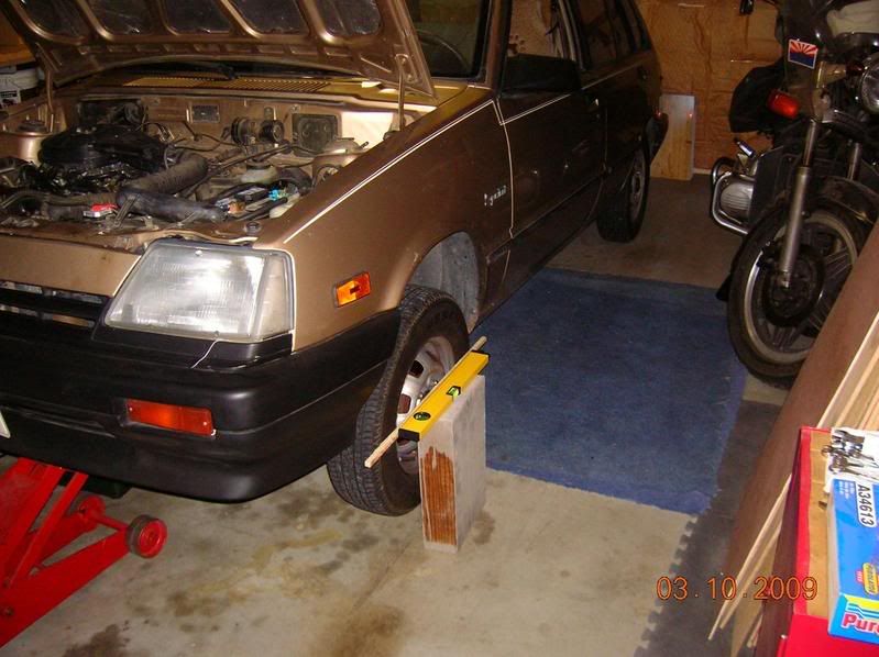

The old DIY Alignment thread seems to be missing a few things.
Here's a quick and easy way to do it.
Just get a block of wood, a laser and a flat wall somewhere.
Put it together something like this:
(My cheapo $10 laser/level was too short to reach across the tire, so I added an extra strip of wood.)
Instead of pointing the laser forward, I pointed it backwards and here it's hitting the wooden block at the back of the car. Maybe you can see the red dot.
Might be a good idea to check the alignment before you jack it up. I checked it before, during, and after adjustment. The longer length towards the back of the car might give you a little better alignment than shooting it toward the front if the wall is only 2 or 3 feet in front of the car. Kinda like taking blood pressure, eh?(You can take it on the arm, or you can take it on the foot.) Don't be afraid to shoot the laser to the rear.
Spend 15-20 minutes playing with it, and you can get it nearly perfect; steering wheel and all!
That's about as complicated as I can make it.

That's correct. Those pictures were snapped with a PM in mind, but this thread was a 'command performance'.
If you know some old truck mechanics, they used to pull a set of 'duallies' out of the side of the truck using an old trick. We'd jack up the set of tires, and then put a well greased piece of plywood under them. Loosen the center bolts, and you can slide the two wheels and tires, axle and all...out in short order. Makes for quick wheel bearing and seal changes.
You could use that trick here by driving onto a couple of thin pieces of plywood which have grease between them. Then you'd have a 'floating platform' to adjust your wheels. It'd be a bit of a squeeze if you weren't in High School, but it'd work.
Using the jack doesn't add that much time to the job, and makes it easy to get under the car.
Your string idea is great. You can also get very nice results just eyeballing it.

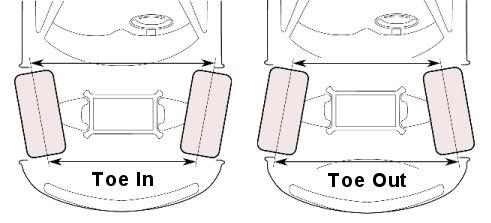

.here's some picture to help
Some will disagree .....I dont think you can adjust the camber on are cars without some modification
I think phil is trying to correct his toe in and toe out adjustment to cure some shimmy/front end viberation
I don't understand the greased plywood thing..??
you adjust the toe in/out on the ground then jack the car up and do it again..??
phil very clever thanks for the post I'm going to try this

1. Thanks for trying to help. I know what toe is. My point is: the red dot is on the wall. Now how does Phil calculate the toe? Toe In spec is Distance at Back of Tire minus Distance at Front of Tire. Measured at mid dia. How does Phil get there?
2. the grease allows the suspension to settle and be realistic under load. I have used grease between sheets of 12" floor tiles. Easy to store. Alternatives of some value :roll: : bounce the fender , roll the car back and forth :lol:
3. My car steers much better with 1/16 toe OUT :D
1/16 IN was scarey on turns over 30 mph :shock: everything front and back was checked out 3 times. just MY weird metro and tires. :lol:
4. My 240z cars have shimmed (ed. shimmied) due to bent rims, tire balance, worn steering and bad Tension compression rods. Not toe.
Just my 4 cents

Like I said, this is as simple as I can make it.
The laser is a certain distance from the tire.
You shoot it the same distance on both sides of the car, right past the rear tires.
Stand in front of the car and just eyeball it. Kinda fun to do, actually.
No string, no tape, no thermal crayon, no 'nothing'...(well, the laser level). Otherwise it's free.
Just shoot the red dots the same, and go for a drive.
Out here, the sun will destroy our tires before the tread wears out.
And that set of tires has been from coast to coast...on that car. Those tires are 5 years old.
Lots of tread, so the alignment works.
I just made a small adjustment because I got a bit close to a curb, and she was pulling a bit.
Now, no more pull.
Snapped the pictures as an after thought. Maybe it will help if you're poor and if your car pulls to one side, or the tires are wearing funny. Not a $20,000 alignment jig, but this is a DIY thread.
You can use it to check any car. Don't even need to jack it up. I can hear it already, "Honey, you hit the curb again..." :lol:
