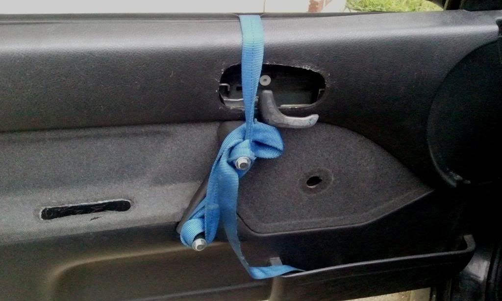

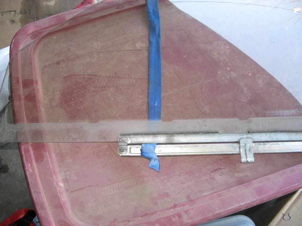

I don't really recommend anybody do this, but while I was waiting on a chance to get the regulator welded I pullled the window up with a strap and tied it off to the armrest to set the height. It was hard to "roll" up with one hand while driving but not hard to open to whatever level you want. Also whistled like crazy unless you open just slightly all the time--have to do this anyway with worn regulators, but if it's that bad you should just fix them anyway. Silly and kind of stupid, but it worked better than the broken regulator (the window could not be rolled down all the way, two hands to roll up). I am concerned the tie-offs I fabricaed could tear out my femoral artery in a wreck
This is seriously rigged, but it's worthwhile to note that with this set up I could take out the windows in less than 5 minutes and I hope it's good for a laugh...

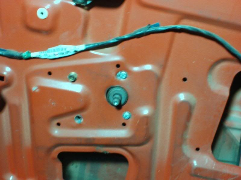

Someone decided to run 3 bolts through the regulator and back them up with nuts on the inside.
Not impossible to remove, but they did bend the bracket a bit.

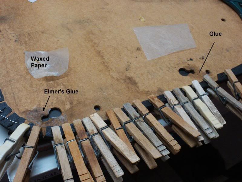

The door card is a particle board which deteriorates easily with moisture.
I shot a bit of water through a spray bottle at this lower section and worked a little bit of Elmer's Glue
into the dark areas with a tiny flat blade screwdriver. Then I covered it with some wax paper and clamped it.
You are looking at the results. Those little holes are now firm and hold the push pins.
I didn't go overboard with the wax paper. Just enough to cover the holes and make it easy to remove, as shown.
Next, I used some weatherstrip adhesive (the yellow stuff) to glue the vinyl to the particle board and clipped it with some clothes pins.

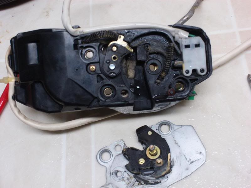

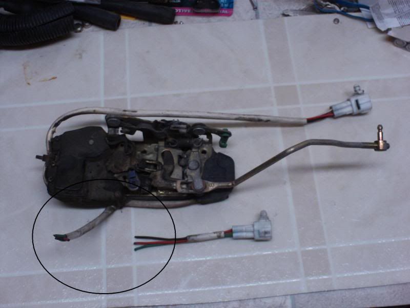

The actual door lock on removal
had a broken set of wires.
That is why I had to take it out of the door.
One Phillips screw and the mechanism is visible for cleaning and new grease:

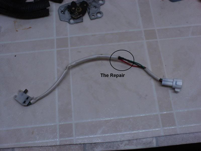

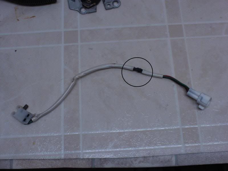

After checking the switch with an ohm meter, it appeared to be working, so it was probably a good idea to solder the wires back together:
and then slide the little insulation back over the shrink wrap

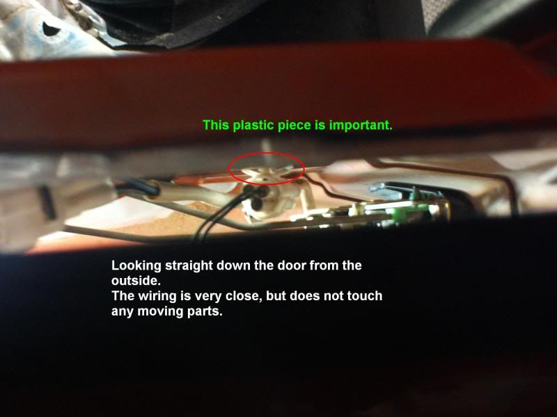

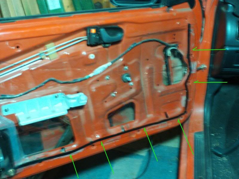

Maybe the last person to fix the door (there was broken glass inside the bottom of the door) didn't route the wires properly, allowing them to be sheared.
Here is a view down the top of the door through the window slat showing how close the clearances are:

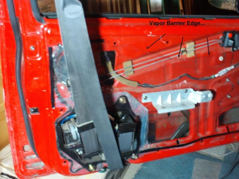

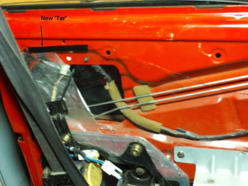

After the lock wiring, window regulator, and door hinges were adjusted lubed and/or cleaned, a new vapor barrier was made using some clear stock obtained at a hardware store and a template. Again, the '89-'92 template is fine, but you have to make allowances for the seat belt retractor.
The clear plastic vapor barrier isn't really visible in the picture unless you look carefully.
There is a black tar like substance which is used to hold that plastic vapor barrier in place.
I always forget the name of that stuff, so I'll look it up again and post it here in case you want to go off and buy some for a later project.
CRL Black 1/16" x 3/8" Butyl Architectural Tape
(note the size; that is stock size...)
'The Devil is in the Detail' so here is a picture of a short section which should also get some of that tape:
and here is another view toward the front of the door; make sure to avoid your push pin holes:

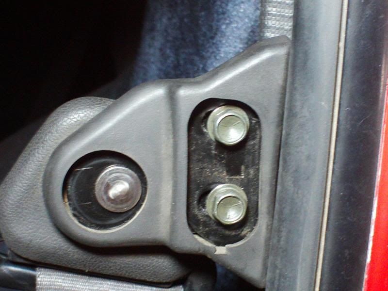

Getting the door to shut right might involve that seat belt metal part at the top of the door.
Use a tiny flat blade screwdriver to pop out the protective rubber cover and you will see 2 bolts which take a 10 mm socket:
and it should be a snap to fix that if it is hitting.

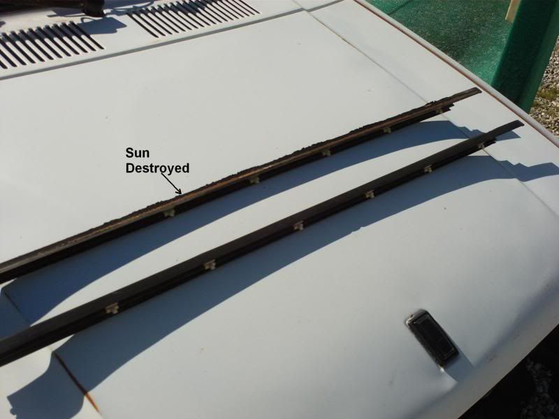

You should also dig out a spray bottle of silicone for your window runners, and I found a part of one runner on the floor of the door, so I needed to pull out the 'weatherstrip adhesive' and glue that part back into the metal window channel.
