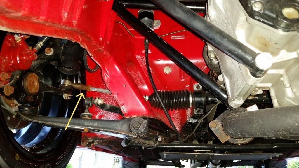

Its very cool and I'm impressed with the mounting of the engine, looks like it's got a rubber coupler from the gearbox output to a shaft that runs to a reversing box in the tunnel and then another shaft back to the diff, I like the little lever hanging off the engine mount bar to change the gear lever actuation angle.
I have fears over the suspension though, the angle of the steering and lower arms is not good, it will have serious bumpsteer.
Anyone else spot this???
