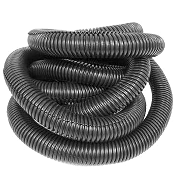

It was interesting how you were receiving correct advice from folks here to check for short circuits and/or wiring problems, despite the initial information that it was the Defogger fuse blowing rather than the Ignition fuse.
You may want to consider examining your other engine compartment wires for chafing or insulation issues that have not yet caused issues.
It is quite common to add flexible vinyl wire conduits to protect the wiring insulation from further damage due to vibration or heat or oil exposure.
Example:
