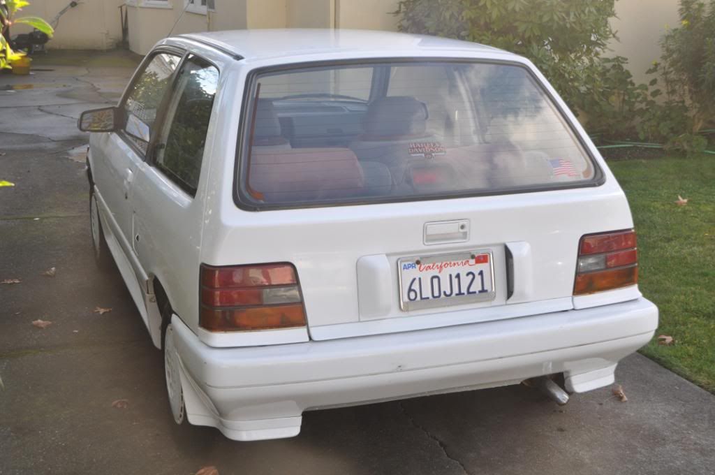

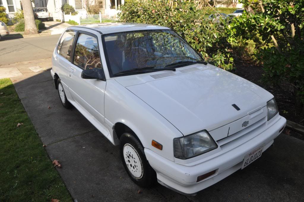

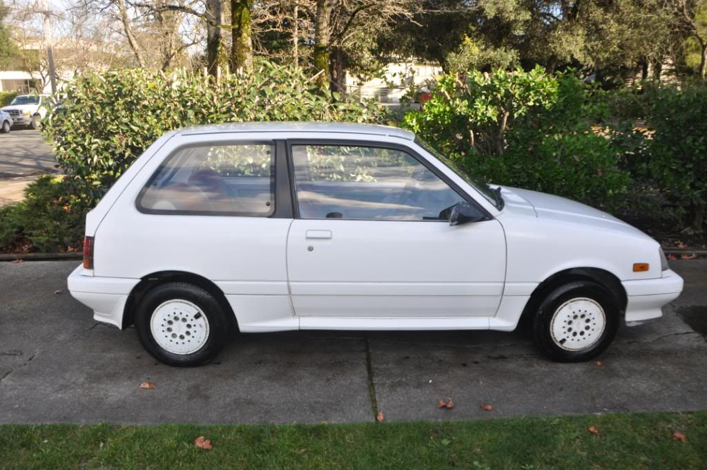

After looking for ages I found my “new” Turbo. It’s white on white and needs some work cosmetically but that’s all part of the fun. There’s 125K on the Chassis but the engine was rebuilt 3000 miles ago, add to that a new turbo, new clutch and hoses and she runs like a champ. All I’ve done so far are a basic Wash and wax but I plan to build on the solid foundation laid by the last owner (thanks Skip!!) I’ll post new updates as I go.
Next step will be replacing the instrument cluster bezel and switches with one in great condition that I pulled off of a non turbo 87 Sprint at PickNPull. I also went and picked up matching paint and supplies to re-spray the mirrors and a couple little problem areas.
I’ll post some engine photos tomorrow
Enjoy

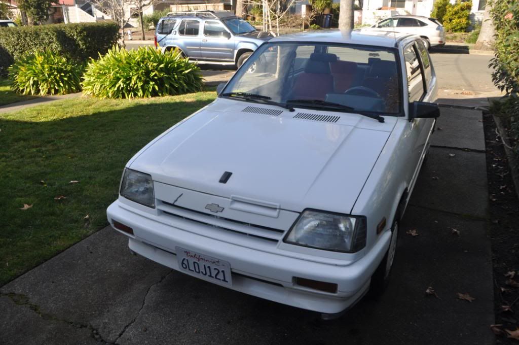

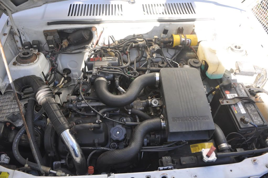

Here’s a shot of the engine bay

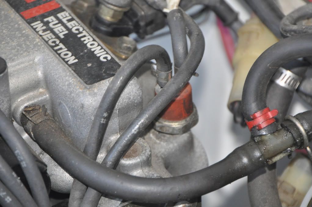

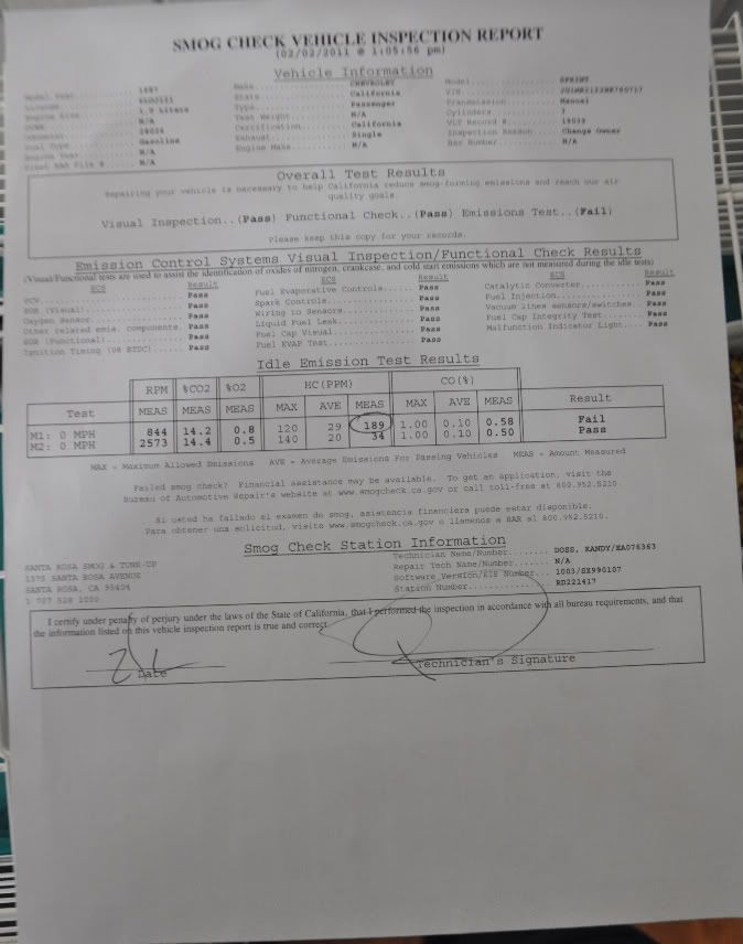

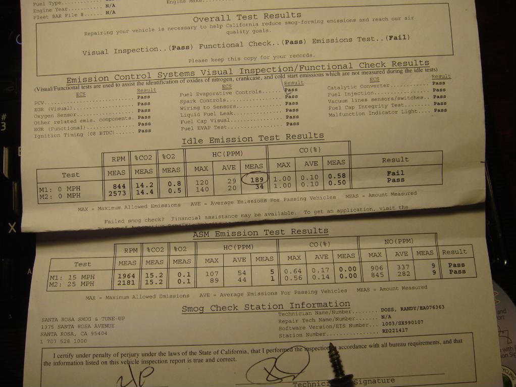

Took it to get smogged today and it failed :cry: To be more precise it passed everything except the idle speed hydrocarbon emissions and it just missed those. Max allowed is 120PPM, the Sprint had 189PPM, sooo close. I found the culprit though, a faulty Thermal/ported vacuum switch. Now the hunt begins. Might have to go back to the wrecking yard sooner then I thought :) Anyway if anyone has a spare Thermal/ported vacuum switch let me know!!
The offending part
Almost made it!!
PostPosted: Wed Feb 02, 2011 8:29 pm
Hard to believe The Coast, where there is supposed to be more 'restrictive' smog testing has the old 4 gas test, while out here in the middle of nowhere (ye ole desert) we have the 5 gas test (which is more difficult to pass).
She almost squeaked through, except for the low speed HC.
What pre-smog preparation was done (oil and filter changes etc) and how 'hot' was the engine when it was tested (did you warm it up by driving on the highway)?
If your CO2 was 14.7, it would have passed. If you just crossed your fingers and gave it to the tech, not a bad first blow; that engine is in pretty decent shape.
That's my 2 cents.

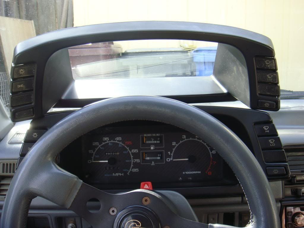

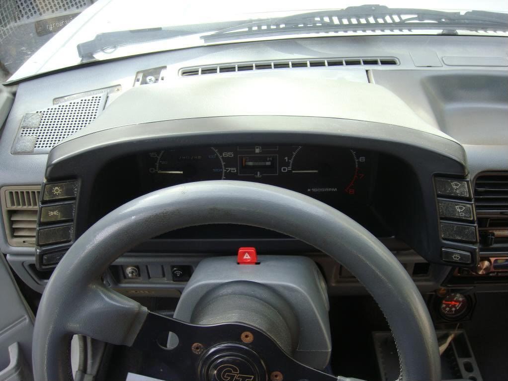

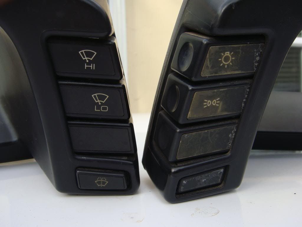

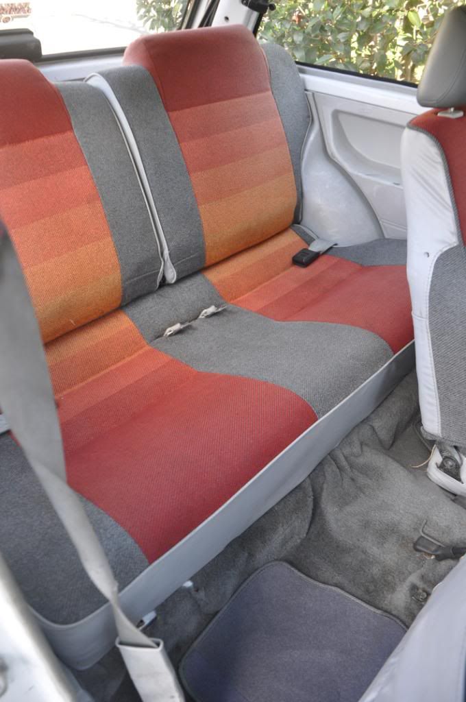

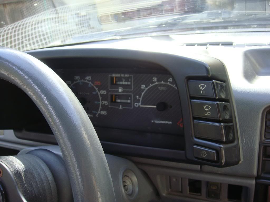

Today I was able to replace the existing instrument cluster/ gauge bezel with a new one. The existing bezel looked like crap and the low speed wiper button didn’t like to click into place, suffice it to say that holding it down in the rain was very annoying. The replacement functions like new and looks like it’s just out of the box. Not bad for a 25 year old part.
Enjoy the photos
The original bezel
Gone
Side by side, difference is tremendous
Fully installed
Tomorrow I’ll post photos of the mirror re-spray

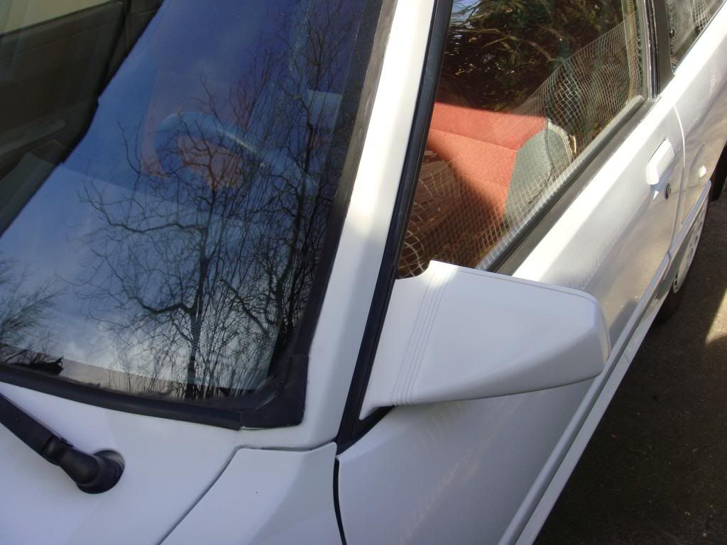

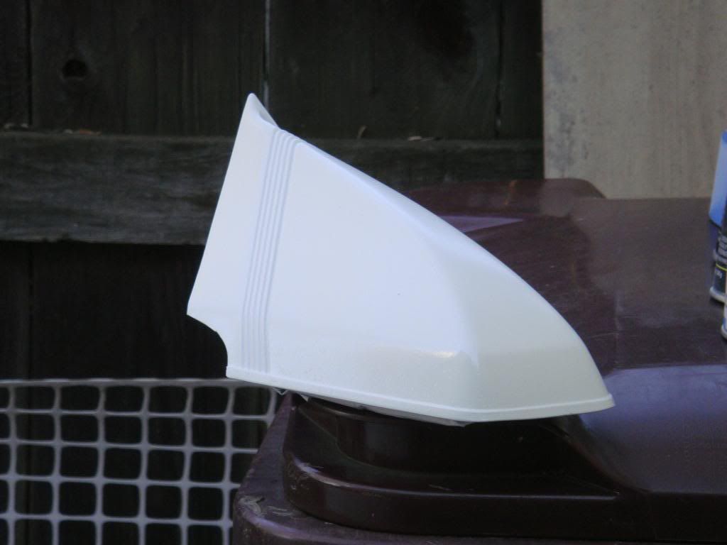

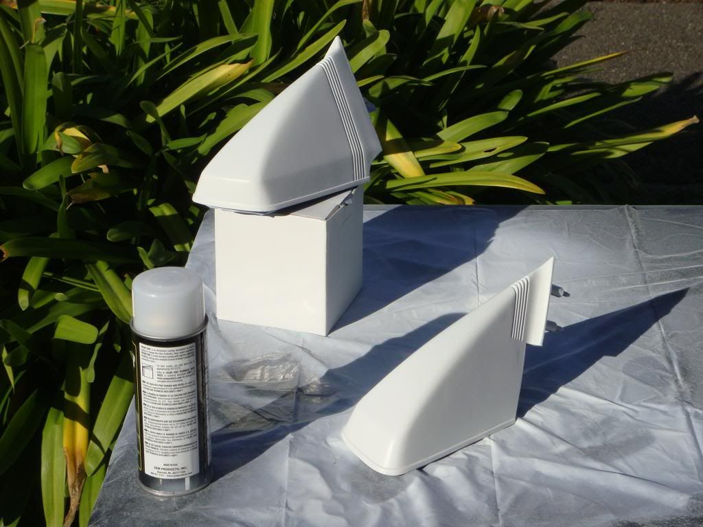

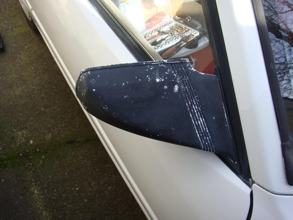

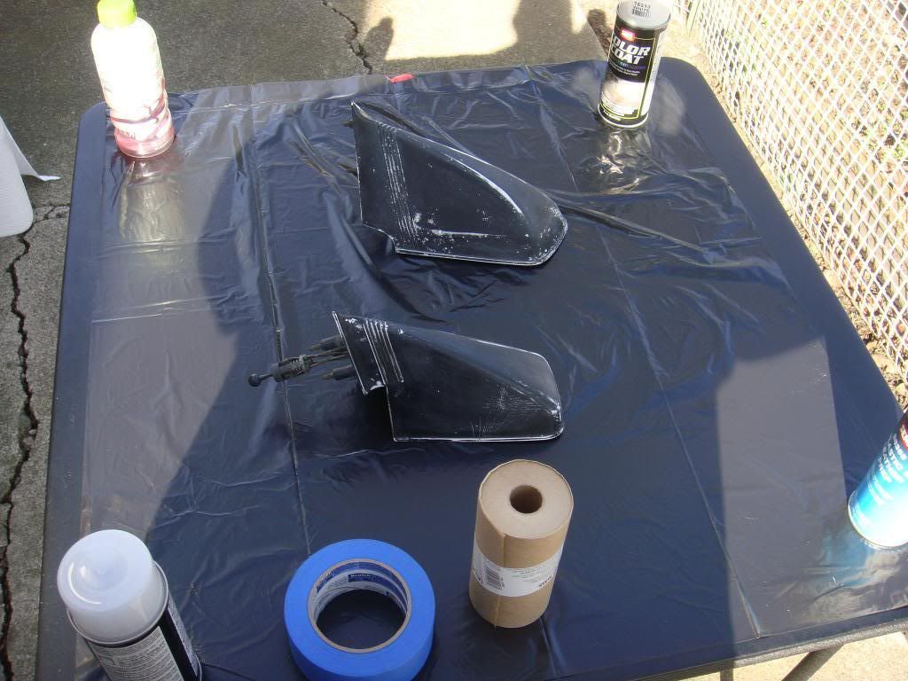

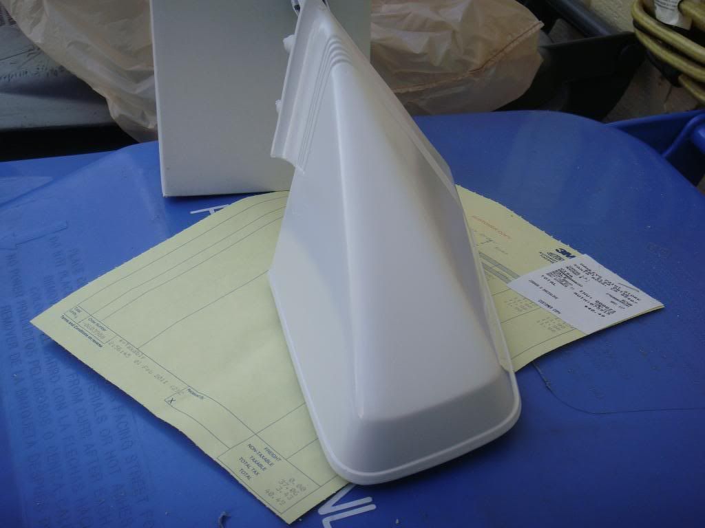

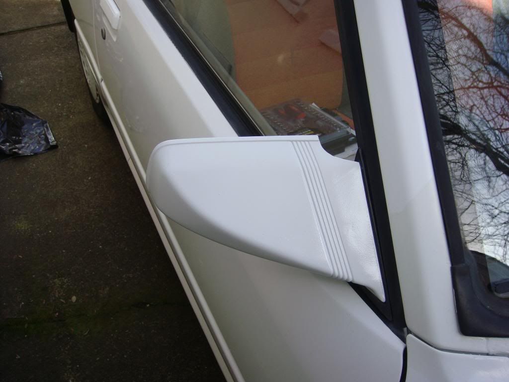

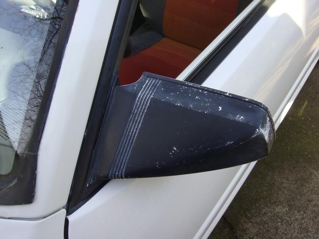

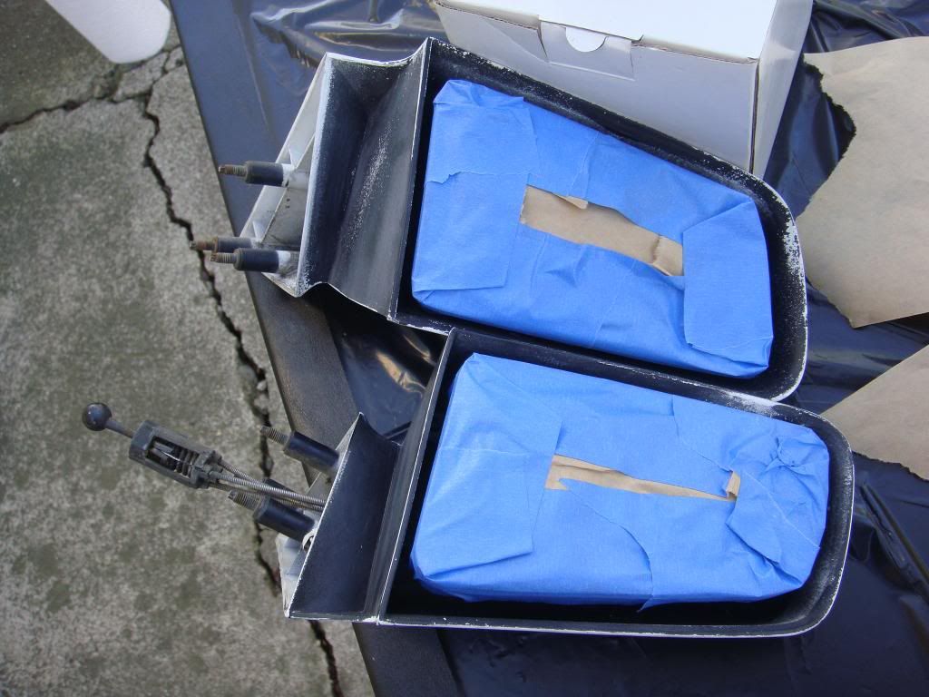

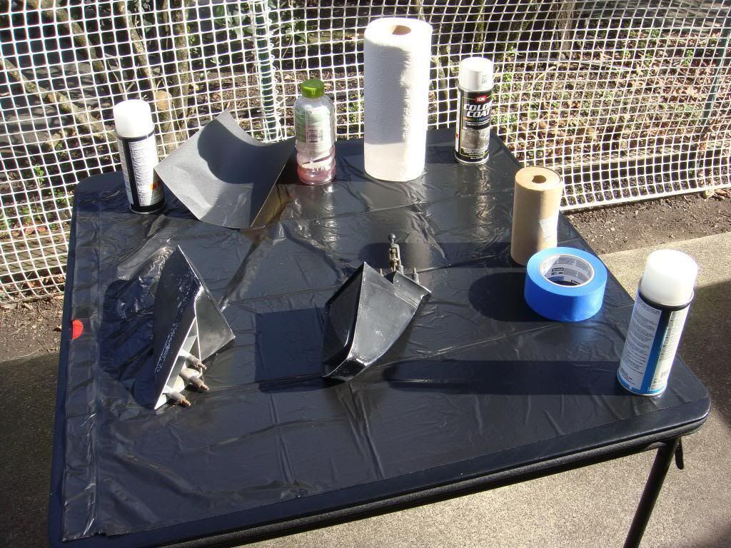

I was able to Re-spray the mirrors today using a 2 step base then clear product by SEM.
Before
The mobile/hi-tech spray booth :)
Sanding and cleaning completed
Fully taped and ready to paint
About half way through the application
The completed mirrors
Installed, makes a huge difference

Smog update: Had everything checked out and the easiest fix was to replace the catalytic converter. Once that was done the Sprint passed with flying colors!! I've attached a pic below to show the difference a new catalytic converter can make.
Also, apparently Santa Barbara County has a different test then Sonoma County. I went down to the DMV and did the transfer of title in-between the two tests, hence the different testing requirements.

The second test station did a better job, especially on the rpms in the first test.
(Hard to do 844 rpms at 15 mph, I'd have to either flunk the machine or the tech... :shock: )
Your CO2 of 15.2 is excellent, and the new cat shows how clean these cars can burn.
Your HC is outstanding; whoever you are getting to work on the car earns his keep.
That's some cat. What brand did you install?
Are you sure he put the sniffer in your tailpipe when he put it on the dyno? :razz:
That Turbo Sprint engine gets an A+++
:thumbsup:
It's a Magnaflow :)
