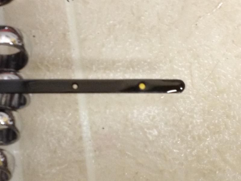

The oil is pretty decent and its pretty hard to see the level:

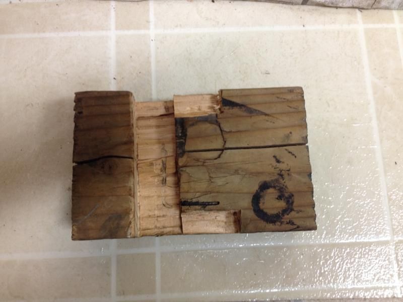

Normally, I put a small 2 by 4 block in the cup of the jack and lift the car from the front or back.
Because I wanted to rotate the tires, it was better to stick the jack under the side.
There's a lip which sticks down, which prevents a person from using a plain block of wood.
This is what I came up with:
It worked fine; not sure why I didn't think of it years ago...although I did post earlier in the week trying to get some floor jack information. Too bad, he had a real chance to help. :-P

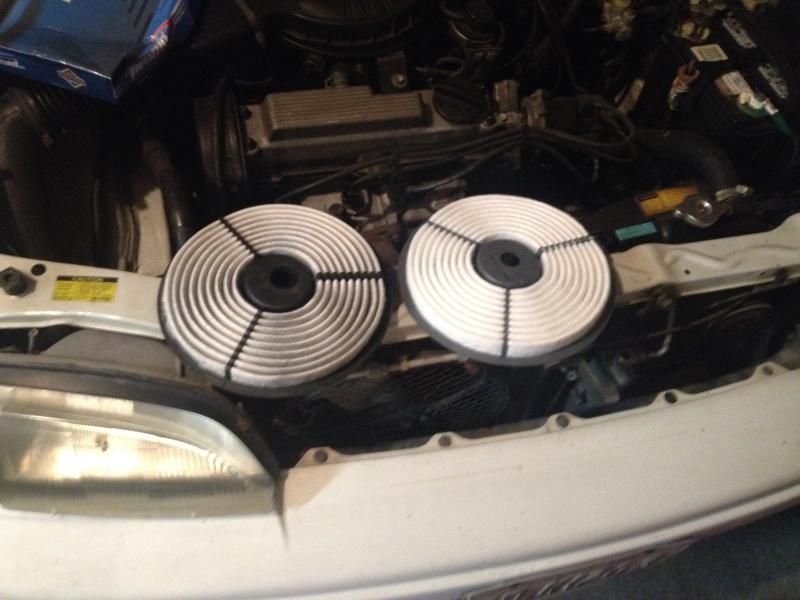

Here's a cheerful thought...change out that air filter!
On line, they are less than $10 delivered.

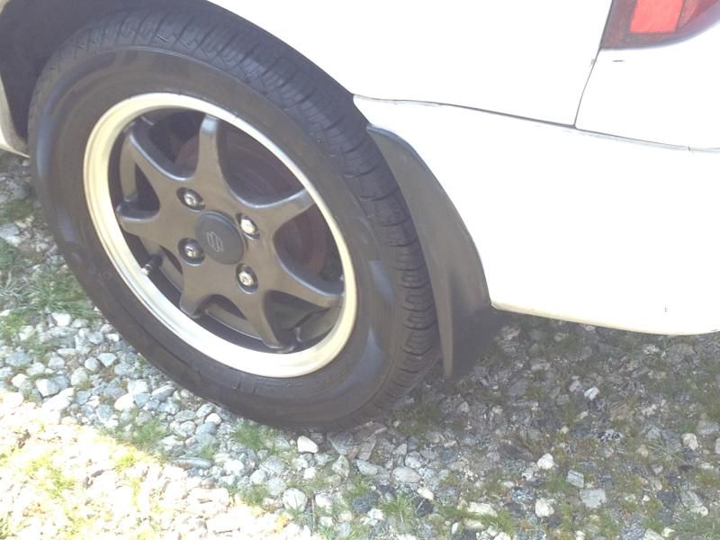

A few pages back I installed some rear mud flaps and the pictures were't so great.
Here's a close up of the driver's side:
They are barely noticeable and really do a great job this time of year.
T3ragtop put me on to them, topdown supplied them for the Wife's car.

I think Phil's losing it. I didn't supply those pieces. I sent him the splash guards that are in the wheel well at the rear of the tire. An invisible part unless you look for them.
