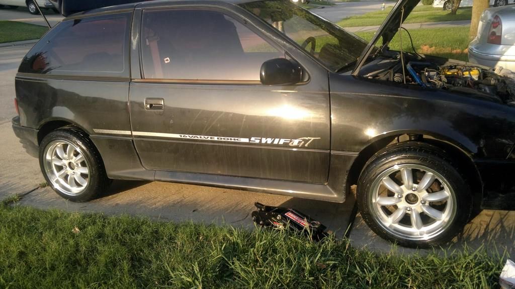

PostPosted: Fri Feb 03, 2017 7:44 pm
I have ET 10 also very common in E.S Central America. But you need 13x7, or like me i have 13X8. 0 offset.
PostPosted: Fri Feb 03, 2017 7:48 pm
Here is an old post of mine. so you can see ET10http://teamswift.net/viewtopic.php?f=10&t=51017&p=410740&hilit=konig+rewinds#p410740
PostPosted: Fri Feb 03, 2017 8:23 pm
[quote="AndyZZZ"]So we're basically have the same setup :lol:
in the UK its illegal if your wheels overhang the arches, because its "UNSAFE" so hence the ET30 not ET20, then again i'd love to do like ET10 and just use some nice wide fender flares
[url][URL=http://s1093.photobucket.com/user/rop74/media/11822975_1638698546370560_1953438733211055573_o_1.jpg.html]Image[/url][/url] This is 15x7
PostPosted: Fri Feb 03, 2017 8:27 pm
Here is ET 0 on 13x8 [url][URL=http://s1093.photobucket.com/user/rop74/media/10255797_1444543849119365_3090883079760215942_n.jpg.html]Image[/url][/url]
