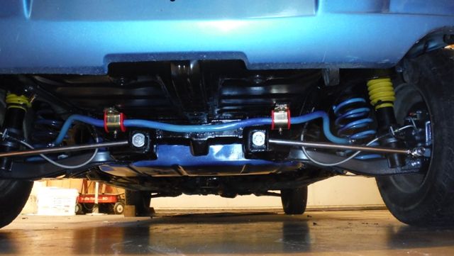

Trying half-heartedly to stay SCCA legal. In FSP I can substitute material from rubber to poly but not to metal and not from flex-type bushing to spherical. There's a bit of grey area for this substitution on control links for safety related reasons associated with RWD cars, but it doesn't really apply. On the other hand, locals I asked about this basically thought suspension was "open" in FSP as long as the original attachment points are used. Not true, but obviously not a lot of scrutiny. I may just go with some decent Heims after all--guess I better get the boots too.
The spacers I made from the existing metric bolts to 5/8 are also not much material so the whole business should still be pretty stiff. 1/2" is even closer, almost to the point of simply wrapping the bolt with teflon tape or something. But others have swapped out to 5/8 or 1/2 bolts? That seems way more difficult on the knuckle side.

Here are the pieces I finally got from Speedway Motors, in case anyone is following:
And on the car:

I went ahead and included the part numbers for everyone because the rod ends were actually very hard to find--heim joints are fine, but I actually think these are better because they don't need to handle misalignment and are actually stiffer as a result. The nylon bushings are also much stiffer than poly while remaining SCCA legal in my class (I think...) if anybody else is in the same predicament.
I should probably replace with 1/2 inch bolts but the original hardware was close enough and I haven't had any problems simply ignoring the slight tolerance mismatch in mounting hardware for now. The rod ends are miraculously so close the the width of the original that it is like they were made to fit. No weird clunking, no binding, just less tendency for rod flex to trigger snap oversteer on corner exit. Hooray!
:D
Note: One of the aluminum swedge tubes had bad threads when it arrived. Speedway sent me another one, no questions asked, but remember to slather your bar ends with anti-sieze as a precaution regardless. Removing the bar end from the bad tube was a minor struggle.

I started out with the tractor links too--it seemed like a good idea at the time, but the Heim joint (sherical metal bushing) wore so quickly that the clunking quickly became unbearable, a common experience documented on here by others that have also tried them.
The bushing in the ones I got from Speedway is actually nylon hard plastic. For reasons I can't yet explain the one on the left side makes a creaking noise when the suspension is compressed through its motions, but it functions without binding and these are doing what I need them to do on autocross days, namely making oversteer a controllable phenomenon rather than a sudden one-way trip to facing the wrong direction (do not pass go, do not collect $200). They are not supposed to need lubrication, but I've thought about trying to grease the creaky one. So, these are a bit noisy and stiff but are continuing to work great for me--I've put about 6,000 miles and 13 autocross runs on them at this point. A much better solution.

I ended up shimming out the small space between the 12mm bolt and 1/2" hole with strips I cut from a beer can. They didn't shift at all during normal driving, but I would sometimes find that my alignment had shifted a mm or so after racing.
They can also make some creaking noises unless you lube them every so often (even though they are not supposed to need it), but they don't bind, and it's nothing like the clunk you get from worn heim joints. I am very happy with the way these work, and while I've recently retired this car to mostly "toy car" status so it gets fewer miles, I've put well over 10,000 miles on this setup at this point with no problems.

While I wrestled them into place a couple of times without it, I eventually filed a tiny bit off the bottom of the inboard "box" that they bolt up to so they'd slide easily into place with less drama. When you install them it will be quickly obvious where to file.

A quick update on dealing with the hardware mismatch: They are pretty simple so I got a local machine shop to make replacement inserts for the nylon that fit the metric bolts exactly.

Great! No problems, no clunk, just work :D
