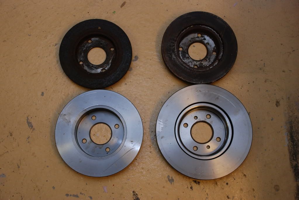

Nissan SE-R Spec-V 2006 oem big brake Brembo kit rotors
rear disc
The Nissan rotor is heighter than the Swift rotor, but it fit the rear hub without any rubbing
Swift OE disc diameter
Nissan brembo disc diameter
Front disc
Same height
Overall view :twisted: :twisted:

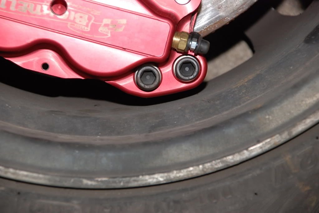

There is a setup of a friend
11'' Nissan Sentra SE-R 2004 front rotor + Bicknell 4 pot caliper + custom bracket
***15 inch wheel minimum***

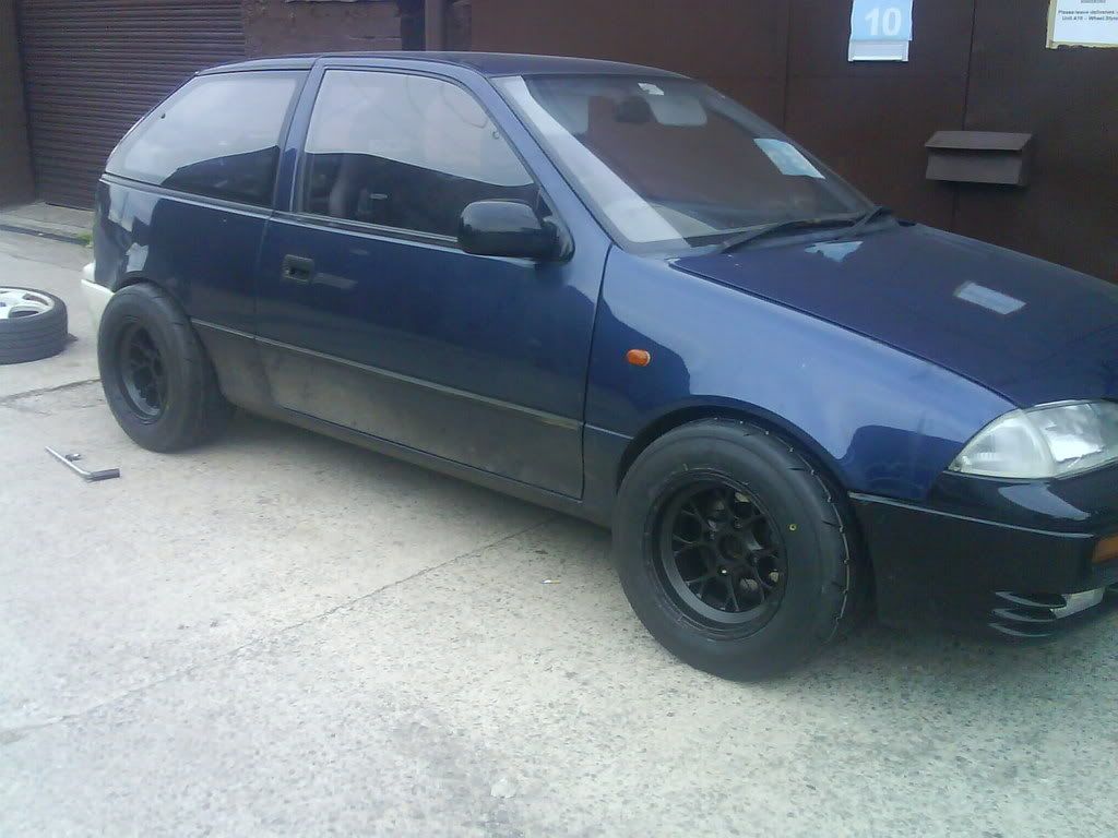

or this setup.....that fit 13'' wheel :blackeye: ....don't know more about this setup
john49 wrote:
Just got my new 13 x 8 rims today, These are 4kg's a rim :shock:
They fit just perfect over the 4 pot calipers

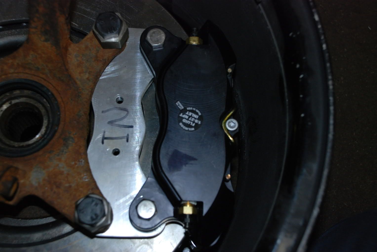

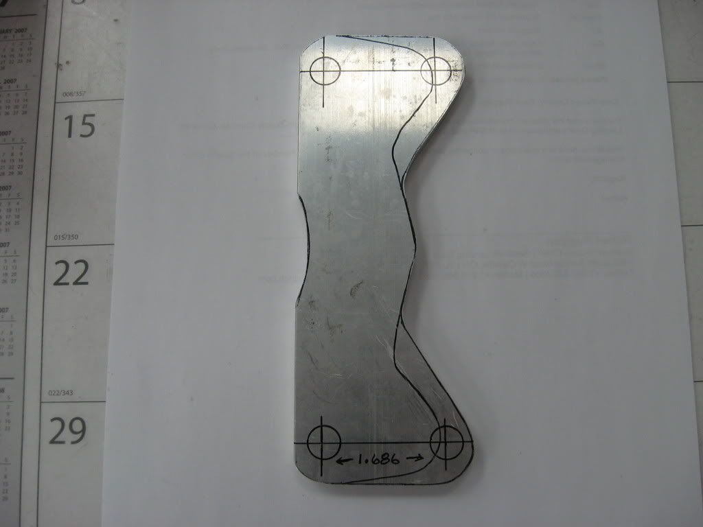

Some update on the wilwood setup.....don't have pisture of the rear bracket.
As you can see, the rotor are way too big for the caliper...or :mrgreen: the caliper are way to small for the rotor
Doesn't matter, I love the way it look.
Rear bracket in 3d

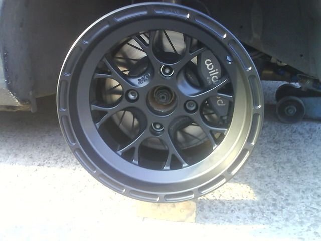

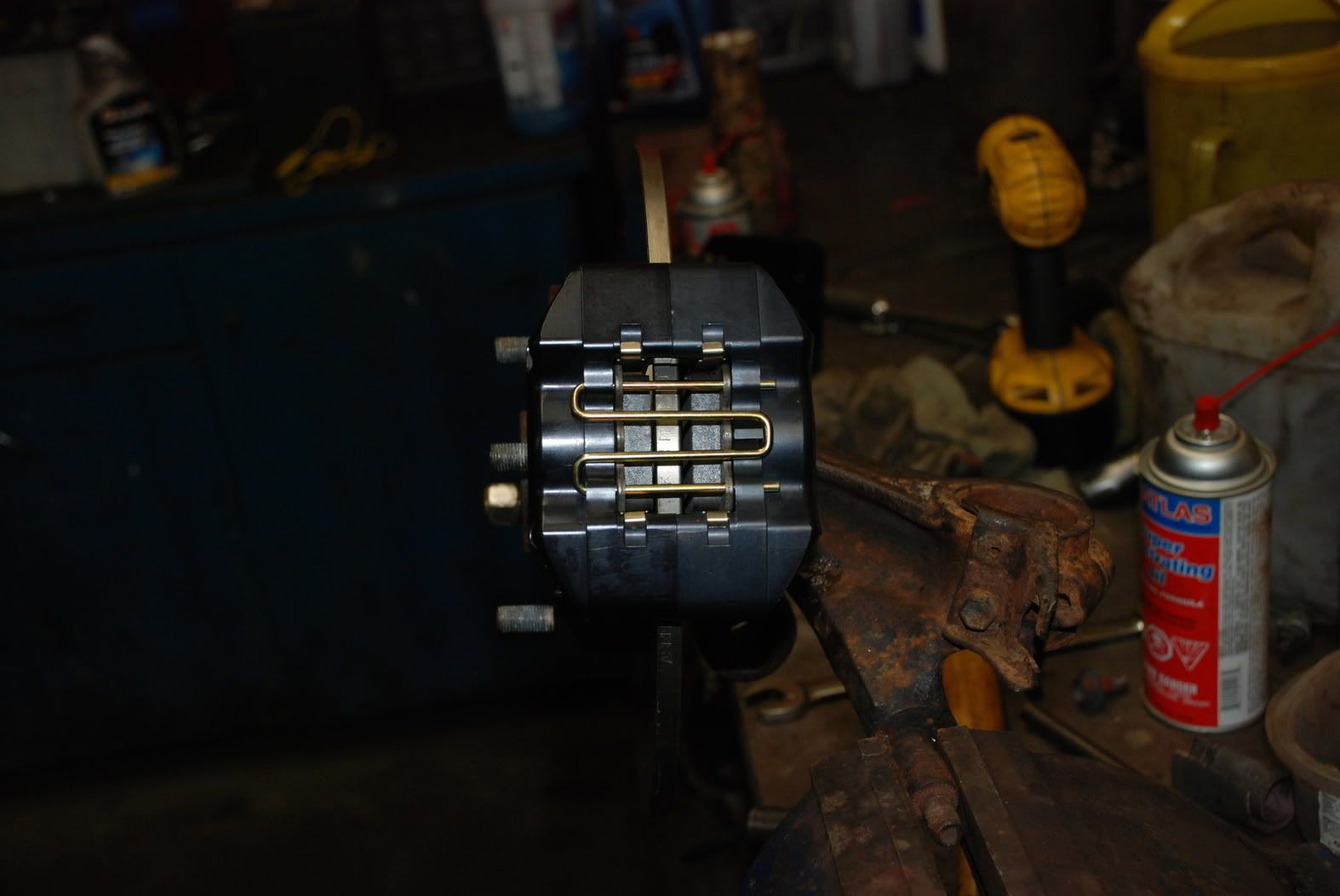

Some photos of the rear installation
And the front
Don't freak-up the nut on the hub bolt are there because my bolt was too long :wink:

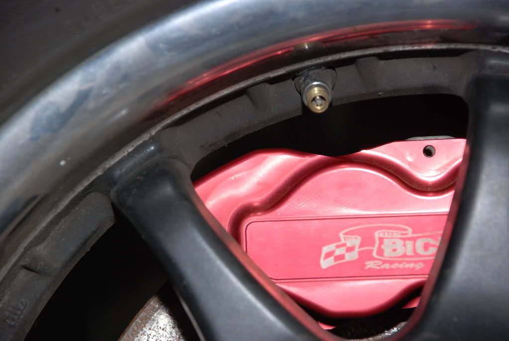

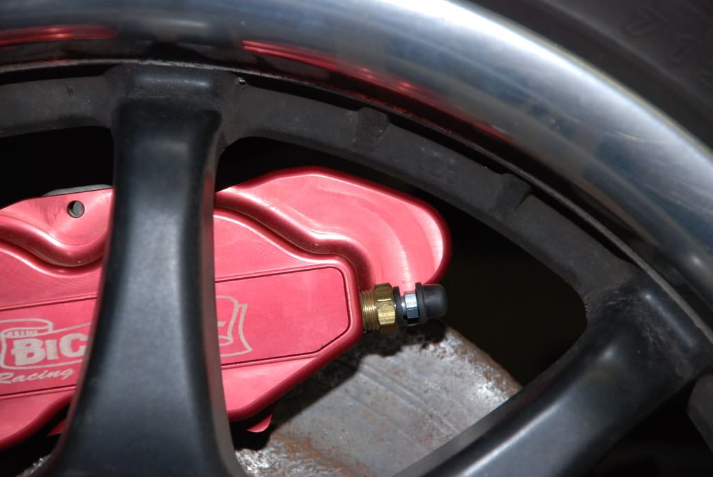

A setup of a friend of mine
11'' Nissan Altima Rotor
15'' wheel
Bicknell race caliper
Serious GT wrote:
Some news
Suzimaniac.

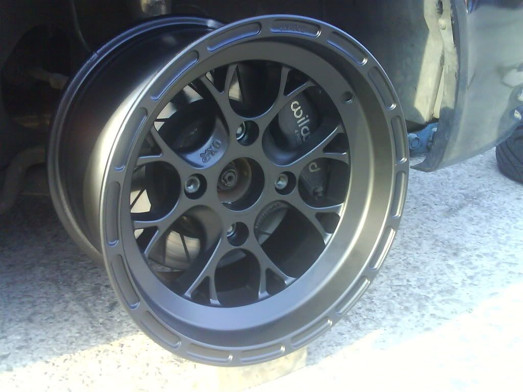

what wheel is this?

COOKIEMNSTR wrote:
what wheel is this?
13X8 wheels :shock:
Redlinegti post:
http://www.redlinegti.com/forum/viewtopic.php?f=4&t=34964

Out of topic but could u tell us brand ond offset of those beutiful rims....
Thanks
89 Suzuki Swift Turbo
03 Infiniti G35 sedan
PostPosted: Fri Apr 03, 2009 9:57 am
Joined: Mon Mar 14, 2005 10:19 am
Posts: 361
Location: Canberra, Australlia
Compomotive CXR's
